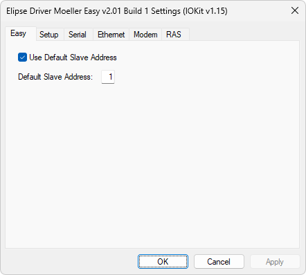

All configurations are performed on the Easy tab on the properties window of this Driver, shown on the next figure.
Easy tab
Easy tab
The Use Default Slave Address option allows configuring a default value to use as the address of a Slave Easy device. This option is selected by default and the default value of the Default Slave Address option is 1 (one). If the Use Default Slave Address option is selected, any value used in the N1 or B1 parameters of this Driver's Tags are disregarded.
