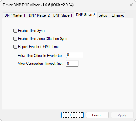

DNP Slave 2 Tab
DNP Slave 2 Tab
DNP Slave 2 tab
DNP Slave 2 tab
Available options on the DNP Slave 2 tab
Option
Description
Enable Time Sync
Informs whether this Driver accepts requests for clock syncing, which by their turn sync Windows clock
Enable Time Zone Offset on Sync
Informs whether, at the time of syncing, this Driver considers the time offset relative to the time in GMT
Report Events in GMT Time
Changes the timestamp of Tags, transforming them to GMT time based on Windows regional settings and daylight saving time
