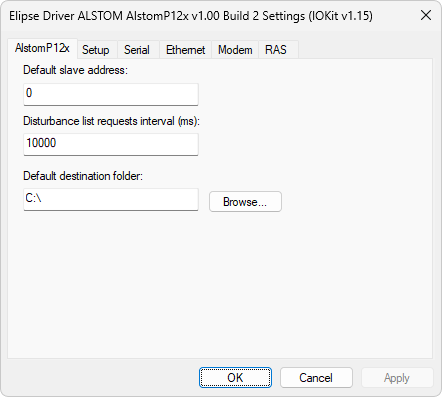

When clicking Driver Settings, the window on the next figure is opened.

Available options on the AlstomP12x tab
Option
Description
Default slave address
Default address of a device. When the address of a device is not informed in Tags, that is, it is equal to 0 (zero) or empty, the value of this option is then considered as the default address
Disturbance list requests interval (ms)
Time interval between requests for reading files in COMTRADE format. Whenever this interval expires, this Driver communicates with a device. If there are new files to update, this Driver provides a reading process and the generation of these files
Default destination folder
Destination folder of files generated in COMTRADE format
Browse
Opens a window to select the destination folder for files in the Default destination folder option
