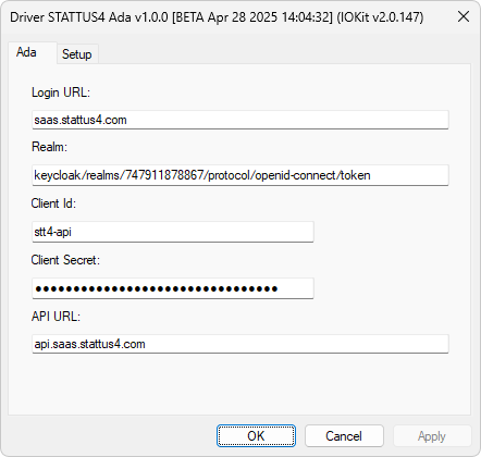

The Ada tab contains specific configurations for this Driver.
Ada Tab
Ada Tab
Available options on the Ada tab
Option
Description
Login URL
URL of the login to a Stattus4 Ada system
Realm
Complement to the login, which must include the name or identifier of the authentication domain (Realm)
Client Id
Login name of a Stattus4 Ada system
Client Secret
Password for the login
API URL
URL of a Stattus4 Ada system's REST API where the web services are located
IoT API URL
URL of a Stattus4 Ada system's REST API where the IoT web services are located
INI File Path
Path and name of a file in INI format for device commissioning. Please click Select a file to open the standard window for selecting files

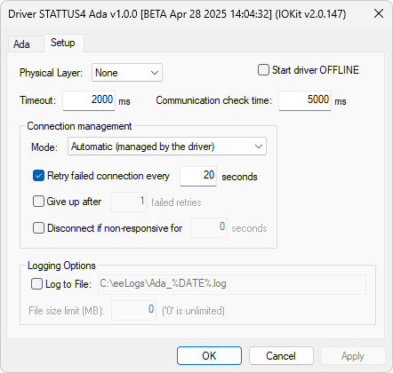

The Setup tab contains general configurations for this Driver. This tab is divided into the following groups:
•General configurations: Configurations of a Driver's physical layer, time-out, and initialization mode (they have no effect for this Driver)
•Connection management: Configurations on how a Driver keeps a connection and which recovery policy is used on failure (they have no effect for this Driver)
•Logging options: Controls the generation of log files
Setup tab
Setup tab
General options on the Setup tab
Option
Description
Physical Layer
For this Driver, the only option available is None, that is, no physical interface is available
Timeout
This option has no effect for this Driver
Communication check time
Start driver OFFLINE
Options on the Connection management group
Option
Description
Mode
Retry failed connection every ... seconds
Give up after ... failed retries
Disconnect if non-responsive for ... seconds
Options on the Logging Options group
Option
Description
Log to File
Enable this option and configure the name of a file to write a log. Log files can be large, so use this option for short periods of time, only for testing and debugging purposes. If the %PROCESS% macro is used in the log file name, it is replaced by the identifier of the current process. This option is particularly useful when using several instances of the same Driver in Elipse E3, Elipse Power, or Elipse Water, thus allowing each instance to generate a separate log file. For example, when configuring this option with value "c:\e3logs\drivers\ada_%PROCESS%.log", it generates a file named c:\e3logs\drivers\ada_00000FDA.log for process 0FDAh. Users can also use the %DATE% macro in the file name. In this case a log file is generated every day, in the format aaaa_mm_dd. For example, when configuring this option with value "c:\e3logs\drivers\ada_%DATE%.log", it generates a file named c:\e3logs\drivers\ada_2005_12_31.log in 12/31/2005 and a file named c:\e3logs\drivers\ada_2006_01_01.log in 01/01/2006. Similarly, the %DATE_HOUR% macro generates one log file per hour, in the format aaaa_mm_dd_hh
File size limit (MB)
Configure the size limit of a log file, in megabytes. A value equal to 0 (zero) means that there is no size limit for a log file
