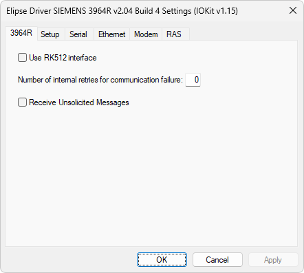

Use the properties window of this Driver, shown on the next figure, to configure some parameters for interfacing with a device.
3964R tab
3964R tab
The available options on the 3964R tab are described on the next table.
Available options on the 3964R tab
Option
Description
Use RK512 interface
Enable this option if a device communicates using an RK512 interface
Number of internal retries for communication failure
This option defines the number of internal retries this Driver performs before returning a communication error to an application. Configure this option in 0 (zero, default) so that this Driver does not perform any internal retry and return, immediately, an error to an application at the first occurrence of a communication failure with a device
Receive Unsolicited Messages
Enable this option only if a device is programmed to send unsolicited messages
